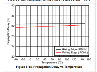

    The original UCC21530 is no longer made. It has been completely updated to a much stronger, simpler design during last year's PCN. All prior PPM information is now historical. The UCC21551 is the same output as the new UCC21530's output side, but has a cost optimized 5V input.
    The fixes are working and the PPM is no longer a concern.
    One major advantage of the new design is its low tp vs. temperature coefficient (below). No competitors can match this performance, and they require adding 10ns more deadtime, which lowers efficiency and high-frequency use. The TI device also delivers lower switching losses than Infineon, due to their high resistance PMOS. Most importantly, it is offered at a lower cost, due to TI's investment in 300mm wafer manufacturing.
