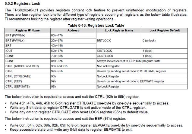

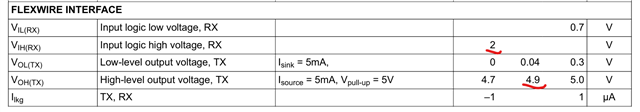

TPS929240-Q1: I don't see any frame on the TX pin of the TPS929240
Part Number: TPS929240-Q1
Other Parts Discussed in Thread: TXS0102
I have a design with five TPS929240 ICs, where the TX and RX pins are directly connected to USART2_RX and USART2_TX on the MCU, respectively. I use an STM32 as microcontroller. After powering up the PCB, the RX pin of the TPS929240 is at 3.3V, but the TX pin is at 0.5VI know that TX should be 5 V when no frames are being sent, this is correct?
The LDO pin of each LED Driver outputs 5 V confirming that each IC is energized correctly.
What could be causing this issue? Could it be due to the lack of pull-up resistors on these pins, or is it related to my initialization code?
My initialization sequence is as follows:
  1. Power up the PCB.
  2. Enable PWMFREQ[3:0] = Ah (2000 Hz).
  3. Set ENOUTXn = 1 for all outputs.
  4. Send frames for PWMOUTXn and PWMLOWOUTXn registers (BRTLOCK is unlocked)

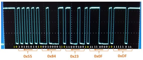

This is the structure of my frame (0x55write/read-burst-address of the LED Driver | address of the register datacrc):
// To send an UART frame to LED driver
void send_uart_frame(uint8_t address_device, uint8_t address_register, uint8_t data) {
    uint8_t frame[5];
    frame[0] = 0x55; // Synchronization
    frame[1] = address_device;
    frame[2] = address_register;
    frame[3] = data;
    frame[4] = calculate_crc(frame, 4); // CRC calculation
    HAL_UART_Transmit(&huart2, frame, 5, 100); // Send frame by UART

Also I tested with enable CLRPOR and enable REGDEFAULT:
// Enable CLRPOR to 1
send_uart_frame(0x81, 0x91, 0x01);
send_uart_frame(0x82, 0x91, 0x01);
send_uart_frame(0x83, 0x91, 0x01);
send_uart_frame(0x84, 0x91, 0x01);
send_uart_frame(0x85, 0x91, 0x01);
// Enable REGDEFAULT to 1
send_uart_frame(0x81, 0x94, 0x01);
send_uart_frame(0x82, 0x94, 0x01);
send_uart_frame(0x83, 0x94, 0x01);
send_uart_frame(0x84, 0x94, 0x01);
send_uart_frame(0x85, 0x94, 0x01);

  • Please add pullup resister. You need it to pull TX up to high voltage.
  • Thanks. I'm going to rework the PCB. I have more doubts.
    1. Can I connect this pullup resistor to 3.3 V or does it have to be 5 V?
    2. Is it enough to just put pull-up resistor to TX, should I put a pullup resistor to RX as well?
    I already tried connecting the pullup resistor only to TX at 5 V but it still didn't show up the frames (stays at 5 V).

    The frames on the RX pin of each TPS929240 are as follows.
    6. Is this format correct?

  • The schematic shows that you are using TPS929240A instead of TPS929240, so the DEVADDR[3] = 1.  Please try different address like 08h, 0ch instead of 00h and 04h.
  • Thank you. I've already received an answer from the LED Driver, it already worked for me, what I have to improve in the schematic is the following:
