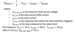

First question: is the TSHORT parameter specified somewhere? It is only mentioned in section 9.2.4.4.3 of the DS and it states it is 30us. Is this value right?
Webench selected Si7135DP which is a beast. The problem is space is limited in my design and its package is relatively large and, if the formula above is right, "it is overkill" is an understatement.
Using my design's parameter makes Qshort = 19 * 20 * 30e-6/2 = 5,7mJ which corresponds to 190W (mean) for 30us.
Looking at the SOA graph for Si7111 (package takes ~1/4th of the area), 20A is between the limits for 1ms and 100us pulses and current for 100us pulse is ~400W @ 20V, it would be more for 30us so this part could be used in my design if my rationale is correct, assuming the 30us (which I guess is typical).

    1. 30us is an estimated value including current rising and shutdown delay.
    Usually, the time will be shorter than 30us.
    2.Tshort is related to the short condition.
    When the device is short with a long wire and the current can rise with a slow slew rate, the time will be longer.
    As is said before, we have a rough test as estimated it to be 30us max.
    3. I think your rationale is right,  Si7135DP is too large for the case, and Si7111 is ok.
    4. The part is acceptable, in our EVM, a 3*3 MOS is used as well.
    5. no other suggestion.
