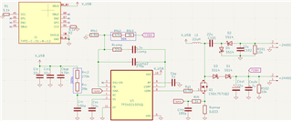

  • Hi Brigitte,
    I've checked the PMP10091 reference design you shared and made several simulations using WeBench PowerDesigner, which helped me come up with the following design.
    Since I'm not very experienced with this type of design, would you mind taking a quick look to see if it appears reasonable?
    Thank you for your help.
  • Hello Quentin,
    Looks good for me. As best practice, I would add the capability to turn off the IC via a resistor on DIS/EN to VDD, but it is not necessary.
    In addition, I would add a relatively big resistor in series to C101 just in case it is needed due to high current spikes. As well not really needed.
    Brigitte
  • Hello Brigitte,
    Thank you very much for the feedbacks!
    I'll proceed with prototyping.
    Best regards.
