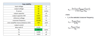

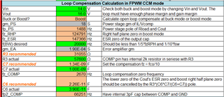

I found the result is loop compensation part different if using formula from datasheet and using calculation excel tool.
why?
why?
Hi Liping,
Rsense is not output current sense resistor. You can use 1/(17+Ioutmax/2.5) to calculate Rsense.
Excel tool also considers efficiency, so there will be still some difference.
Mulin
