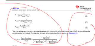

In the datasheet, I can use formua 24)~25) to calculate the external component connecting at comp pin.
question is , should I do any check formula 19)~23) ? I am not sure what should I do .
Hi Liping,
Recommend to use excel tool to calculate the loop compensation in case you use wrong value in the datasheet formula. The formula itself is right.
