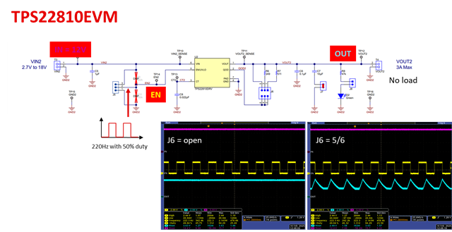

Hi Team,
I expect that I can see the 12V output with PWM 50% at 220Hz. But the output waveform is weird. May you let me know why we can't get the output normally and how can we get the desired 50% duty Vout? Thank you.
In addition, when EN = Vin, I can get Vout = 12V DC.
