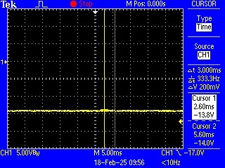

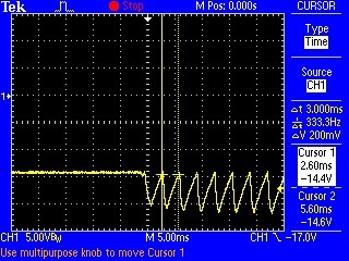

I need some advice to get a stable operation on negative output of TPS65131.
Positive output is fine but negative output has fluctuation (seems like resonant) from time to time..
Target negative output voltage is 13.7V in my design, so one of feedback resistance  is chosen 88.7kohm
instead of  121.2kohm on TPS65131 data sheet.
I selected feedforward capacitor, 7.5pF, based on TPS65131 data sheet.
Should I change feedforward capacitor ? Or what should I do to make stable operation in my design.
I appreciate any advice from you.
