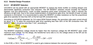

The customer has a sysc rectifier need, customer's topology is two-switch flyback in Air-condition outdoor unit power. And his max frequency is about 130kHz and second-rectifier mosfet's Rds(on) is about 7mΩ.
I have these question as below:
1、What's the hero product in SR product, and pls promote a suitable hero product to meet customer's spec? what's the main application EE?
2、Customer wonder if UCC24630/UCC24612 have the mosfet's Rds(on) limitation?
