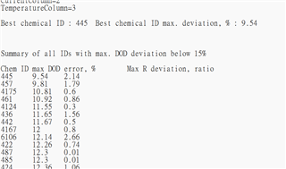

Hi TI Team,
I hope you're doing well. I have a question regarding the BQ40Z50 when used with LiFePO4 cells. I uploaded the charge and discharge settings to the GPC tool, and the GPC report suggested that the best chemistry ID has a maximum deviation of 9.54%. I'm wondering if this deviation would cause significant capacity errors in the entire battery pack (4S8P 32Ah) during charging and discharging.
If it does, are there any ways to improve this? Also, is impedance track less accurate when applied to LiFePO4 batteries?
Looking forward to your advice.
