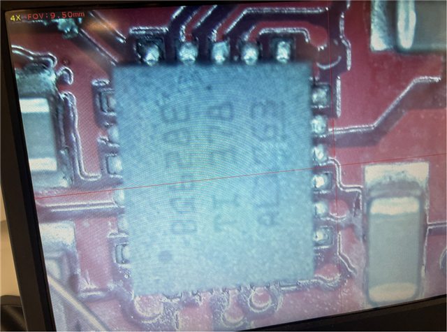

  • Hello Garrett
    Please find attached requested image , though would there be any other alternative to get the information , as from data sheet not able to get the required information of IC version
  • Hi Parimal,
    Thank you for your response. Unfortunately, there is not an alternative method to verify age of the specific unit in question. The top markings on the IC allow us to look of the specific production lot.
    Based on the provided photo I can confirm this specific unit is an 'older' IC and expected Watchdog timer at default setting is 40 sec. Based on this the IC appears to be behaving as expected. The unit was manufactured in 2023 prior to product change in early 2024.
