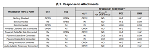

Hi team,
I am confuse the below list in TPS25820 datasheet: When various type-c port, Why CC1 and CC2 have various status? Where Ra and Rd comes from ?
BR
Amber
Hi team,
BR
Amber
TPS25820 is a source only Type-C controller which mean the device will only present Rp. To form a connection in Type-C world the device needs to see pull down resistors from far end. Ra and Rd are pull down resistors from far end device but have different pull down resistance range
