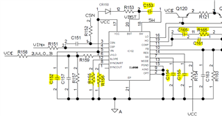

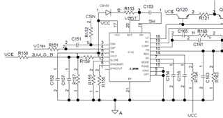

The following figure is the schematic diagram of the specific application peripheral circuit of the LM5122MHX/NOPB chip. The input voltage VIN+ is stepped down and stabilized by LDO to output VCC (10v) to power the chip. The input voltage VIN+ is connected to the chip CSP pin through the R151 (10kohm) resistor. The chip VCC (10V) is powered normally, and the UVLO pin voltage is divided by 1.5V (satisfying greater than 1.2V).

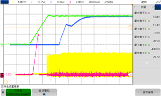

1. At room temperature, under different VIN+ rising slopes (VIN+ rises from 0V to 28V), the chip works normally and LO is driven. The following figure shows the test waveform of VIN+28V input at room temperature (the rising slope is 1V/ms, that is, VIN+ rises from 0V to 28V in 28ms). The green CH3 channel is the VIN+ rising waveform, and the yellow CH1 channel is the LO waveform.

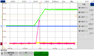

2. At low temperature of -40℃, when the input VIN+ rising slope is 1V/ms (i.e. VIN+ rises from 0V to 28V in 28ms), the chip works abnormally and LO is not driven. The following figure shows the test waveform of low temperature of -40℃, input VIN+28V (rising slope is 1V/ms, i.e. VIN+ rises from 0V to 28V in 28ms). The green color of CH3 channel is the VIN+ rising waveform, and the yellow color of CH1 channel is the LO waveform.

    So the device starts up normal at room temperature, but stays in shutdown mode during the same test at -40C.
    If the device does not start switching, it would make sense to check if all conditions for start-up are met.
    Could you do a new test measurement and check the signals for UVLO, VCC and SS?
    If one of these voltages does not rise, it would explain why the device does not start switching.
    Would you also be willing to share the schematic part of the power stage? (inductor, MOSFET, input/output caps)
    In Boost topology, the VOUT should follow VIN if the device is inactive. This does not seem to be the case in your waveforms if the blue curve is VOUT, so I want to make sure I am not missing relevant information about the design.

    1. The main power circuit schematic diagram is shown in the attached BOOST power circuit diagram. The specific parameters are the total input capacitance of 59.4uF, the total BOOST output capacitance of 61.1uF, and the inductance of 2.8uH;

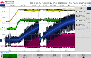

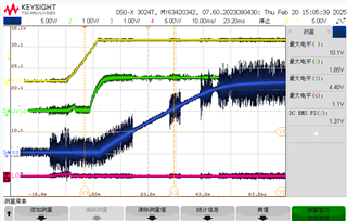

    2. The VCC, UVLO, SS and LO drive waveform test results that meet the startup conditions of the chip are shown in the attached Figure 2 (normal temperature 25℃, input VIN+28V, slope 1v/ms) and Figure 3 (low temperature -40℃, input VIN+28V, slope 1v/ms).
    --According to the test results, at low temperatures, VCC, UVLO, and SS meet the startup conditions, and LO has no drive signal.

    The VCC waveform was tested before, and the power supply of 10v was normal, and the UVLO of 1.4v also met the startup conditions. It was also suspected that the UVLO margin was insufficient, resulting in no startup. Later, we adjusted the peripheral voltage divider resistor and increased the UVLO to 1.8v. The chip still did not drive at low temperatures.
    In addition, there are currently multiple chips with this type of anomaly. Please help analyze the problem and determine whether the conditions for further FA analysis of the abnormal chip are met. Thank you!

    I can offer to review the schematic. For this I would need the value for the peak load conditions, as well as the component values marked here:
    If you are willing to perform additional bench tests on your side, I would ask if you can measure the FB and COMP signal during a failure situation.
    These define the PWM signal once startup is completed.
