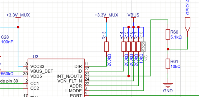

I am trying to deal with INT_N pin of HD3SS3220RNHR , but no luck. May be you could help me. Here is my case:
I connect INT_N via pull to 5V and then use divider to get 3v3 and then connect this to a microcontroller (RP2040) GPIO14, please see an image down below. I also have I2C connected to the RP2040 and I can read / write the data without any problem.
My concern is the low state of INT_N pin regardless what I write into a control register:

Could you point me what did I do wrong?
  • Hi Sergei,
    If anything is being written to the I2C registers, or if anything is happen in the USB-C connection that causes a change to an I2C register, then the INT_N pin should be low, as that indicates a change to an I2C register. The interrupt pin/register will only be cleared by writing 1 to the relevant bit:
    Are you expecting the bit to read high after being read? Have you tried writing to that bit to clear it? The device is setup for I2C mode and not GPIO mode, correct?

  • Hi Sergei,
    Got it, yeah, I believe it should be reset then. I'll double check internally that this is how it's meant to be reset, or if maybe there's another way to do this, though I believe this should work.
    And just to double check, the INTERRUPT_PIN variable refers to the pin of the HD3SS3220 itself, with a 0 meaning there is an interrupt, correct?
    Ryan

  • Hi Sergei,
    Could you try writing 1 to bit 3 of register 0x0A? This should cause the digital logic to reset, I would be interested to see if that affects it.
    Also, could you try writing a 1 to the INTERRUPT_STATUS bit, just to see if it does have any effect?
    Ryan
  • I have tried , but no success. I believe I have a design problem in schematic. Can I somehow privately share the schematic and you suggest me - what is wrong there? In my setup I use two usb-c ports, one is handled by HD3SS3220 and second is by TUSB320LA. both of these chips are having incorrect behavior.
  • Hi Sergei,
    I sent you a friend request over E2E. You can accept that, and then send me a PM of your schematic so its not available publicly. Sounds like there may be something in the schematic.
    Ryan
