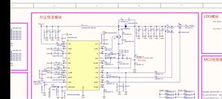

Hi  team,
Could you please help review the schematic and give some suggestions? Thanks.

    How  can you expect me to review a design without any input and output specifications or switching frequency?
  • Hi Daniel,
    The Vin and Vout have been shown on the picture, Vin=12V (9-16V), Vout=33V(Vout max =40V).
    I'm sorry to have missed the switching frequency information, which is 390 kHz.
    Ivy
  • The Voltage RANGE was not shown in the picture and Vout is set to 35V in the picture, not 33V. This is important information for me to evaluate the design. I will get to it ASAP
  • Hi Daniel,
    The vout range is 30-37V, the 33V is the normal value, 40V is the maximum limit value.
    Ivy
  • I looked through the configuration of the components and they look good so far... I have a few questions below:

  • Hi Daniel,
    The vout range is 30-37V, the output current can be divided into two situations:
    For DRL, the external PWM frequency is 5KHz, the duty cycle is 100%, and the current is 170mA
    For position lighting, the external PWM frequency is 5KHz, the duty cycle is 17%, and the current is 29mA
    The problem now is that the LED will blink when the duty cycle is in the 30%-70% range, the customer wants to know what could be the cause of the flickering.
    Ivy
  • Hi Ivy,
    I thought this was a preliminary schematic evaluation... I need wave forms when I have to diagnose an issue post-production. However, 5Khz is extremely fast for PWM dimming, we typically recommend under 1KHz to ensure proper resolution and accuracy.
