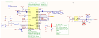

Oddly, this happens on the 15W capable USB-C ports on my laptop but not on the 7.5W capable ones. Here's the schematic around the PD chip:

    On your system I see there is an EEPROM on board, however the A0 A1 and A2 pins are all floating. Upon boot-up (either from VBUS in a dead battery state or 3.3V is applied to VIN_3V3), TPS25751 will look for I2C target address 0x50 to load the PD config. I'm not sure how the CAT24C512 would reach if the A0-A2 pins are floating but I would recommend to ground the pins to get the correct I2C target address set for the EEPROM.

    Regarding the EEPROM, the manufacturer's datasheet mentions on-chip pull-downs on the address pins. So normally, leaving them floating should not be an issue. We have successfully flashed different configurations (various sink PDOs, different signals on GPIO...) and have never noticed a failed update. I will look at the I2C bus on bootup, that is a good suggestion.

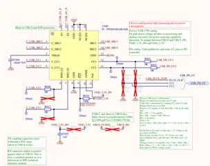

    We have the TPD6S300 connected to CC pins, it should not cause issues but here's the schematic in case you smell something fishy.
    Is it possible that connecting RPD_G1 and RPD_G2 conflicts with the TPS25751's CC pin handling? I will move the jumpers from R608 to R609 and R612 to R615 while I wait for your reply (EDIT: it did not solve the issue, only blocked PD negotiation).

    Quick look at the PD logs, I think we can rule out over-current as the root cause. Both passing and failing logs show roughly around ~500-600mA during the Request->Accept->PS_RDY (in passing log, in fail log no PS_RDY is sent from laptop) unless the laptop has super tight window for how much current can be drawn prior to PS_RDY being sent.
    On your previous design with TPS65982, did you use any protection device like TPD6S300 or was it a direct connection from USB-C connector to TPS65982? Are you able to try and bypass the TPS6S300 (at least for the CC lines) so that TPS25751 CC lines are connected directly to the USB-C connector? Would lie to see if the protection device is causing any issues there.

  • Hi Raymond,
    On our previous design with TPS65982, CC pins are connected to TPD4E05U06. The negotiation also fails when bypassing the TPD6S300 (connecting TP600 with TP604 and TP601 with TP602). So apparently it doesn't cause the issues.
