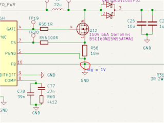

Hi all,
I'm developing a boost converter for LEDs, based on a Webench simulation of the LM51561H. I incorporated modifications aligned with Figure 10-9 of the datasheet to implement a low-side shunt resistor, feeding back into the control loop.
The design is for a Vin of 20-30V, and boost up to 40-50V for a current of 1A or 1.5A (deepening of the shunt populated) it also must accept a PWM on the EN_1 to dim the led
Simulation link for reference: webench.ti.com/.../SDP.cgi
I have increased the voltage rating of the mosfet to allow a voltage output of 40-50V
Despite matching the rest of the component values to the simulation, I can't achieve oscillation. Any insights into what might be preventing switching operation would be greatly appreciated.

  • Hi Oriol,
    Thanks for the feedback.
    Moritz is out of office this week, so I will take over this thread.
    First off, there was a mistake in the first schematic you sent, where FB is shorted to GND. I assume you already fixed this issue as you can run the simulation without problems.
    The device should already have an internal overvoltage protection, meaning if voltage at FB rises to high (10% above target), the device will stop switching until FB voltage drops.
    If the voltage only drops at FB pin while the actual output voltage is still increasing, a zener clamping diode should be the most common solution.
    Niklas
  • Hi Niklas
    It turns out that the FB shorted to GND wasn’t the issue stopping the simulation, and the PCBs we ordered don’t have this problem. i create the short afterwards and does not affect.

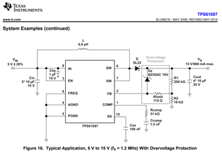

  • Hi OP,
    Thanks a lot for your patience.
    I got some feedback on suitable implementations for your fault protection.
    Here is a schematic idea using a clamping diode from VOUT to FB. (Taken from the datasheet of TPS61087)
    If you are still interested in the approach of shutting down via UVLO, there are indeed some references for this as well.
    Please have a look at this article:
    https://www.ti.com/document-viewer/lit/html/SSZT626
    Please let me know if you have any additional questions on this.
    Niklas
  • Hi Niklas.
    I really like the approach of the Zener. Thanks for the support!
    The Pspice sim showed a nice behaviour with a 100ohm Rz. will let you know once i try in the circuit.
    BR,
    Op
