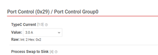

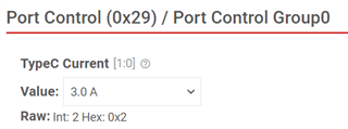

    Do you have a PD log? how are you determining the tablet the output power is 1.5-A?
    Couple things to check:
    1. Check the type-C current in the Port Control (0x29) register and make sure it is set to 3-A

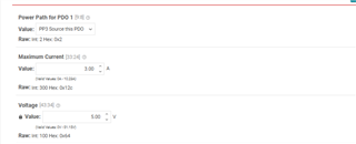

    2. Check source PDO 1 and make sure current is set to 3-A
    If these are both set properly, the limited current could be due to some system state of the tablet. You would need to get a PD log to confirm the messaging on the type-C port to see if it is requesting a lower power PD contract.

  • Hi Chris,
        We use Power-Z KM003C monitor the USB-PD protocol and output voltage/current/power information.
        Check current config:
  • Hi Aiden,
    If you can send us the PD log captured from the Power-Z KM003C we can take a look on our end. From all the settings you've shown us, there should no issues with the configuration. We'll need to see from the PD log why current draw is low.
