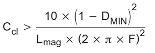

                 I have used LM5034 in my latest design for +28V to +50V conversion with a power of 250W.
The attachment contains the waveform of the VDS of Primary MOSFET and VGS of the same.  The clamping capacitor value has been chosen based on the following formula.
DMIN - 0.279
Lmag - 41.4 uH
F - 500 kHz
Based on the data above, the calculated clamp capacitor value is 12.7 nF.  The actual value used in 20 nF.
Also, the programmed dead time is 50ns.
What can I do, to achieve zero voltage switching in active clamp MOSFET and primary MOSFET?
CH1: OUT1 (Gate pulse of primary MOSFET), CH2: VDS of primary MOSFET.  CH3: Input current.
Kindly support in this regard.
    The ZVS needs the help to get energy from the transformer primary side leakage inductance along with proper dead time. In your input voltage range, ZVS is agreed not to be sought from past two decades practice of active clamp forward since the leakage energy demanded is so large to achieve ZVS that efficiency benefit is not obtained from resulted conduction losses increase and duty cycle reduction.
    Practically, you can play with the dead time to get so called Vds valley switching instead of Vds Zero Voltage Switching.

    In applications of 48V input or nearby and frequency like below 600kHz switching losses are not meaningful with much later investigation than the application note you cited.
    Pursuing ZVS makes efficiency lower. So only need to pay attention of Lm and a leakage inductance 1 to 2% is ok. You can make estimation how much power losses from ZVS saved. Based on we know very insignificant in the applications like yours.
    It looks the dead time is too small then causing VI crossing power losses. You can increase the dead time to see if any help. Increase dead time you can see Vds is at a value between Vin and zero when MOSFET turns on which is called valley switching.
    You need to measure and find where the power losses are and how much then deal with each.
