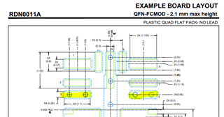

Dear Specialists,
My customer is encountering soldering problem.
I would be grateful if you could advise.
 There are via in the land pattern example in the datasheet.
However when mounting, solder flows into the backside pattern through the board via.
How should this be dealt with?
Should I apply solder resist to the backside pattern?
Or I would like to eliminate the via if it is not necessary.
I appreciate your great help in advance.
