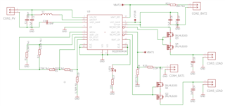

Hi, I have designed a solar charging circuit based on BQ25505. I have connected both the primary (VBAT2 = 3.4v) and the secondary (VBAT1 = 2.4v) batteries.
The problem is that always VBAT_OK pin = 0v and the MUX does not switch from the primary to the secondary battery. (VB_PRI_ON pin = 0v , VB_SEC_ON pin = 3.4v)
I have chosen these resistors:
R_OK1 = 5.76M,  R_OK2 = 6.81M, R_OK3 = 576K, R_OV1 = 6.34M, R_OV2= 6.81M
Vstor = 3.4v
What is the reason for the problem?
