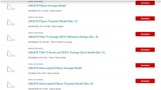

There have some PSPICE model available on ti.com. Would like to check with you if these simulation model can be used in SIMPLIS and SIMETRIX as well?

We only provide support and models for PSpice (and TINA).
I double checked internally, if we have any SIMPLIS models for this device, but unfortunately this is not the case.
I have seen customers who transfer the unencrypted .lib files to another simulator themselves, but they do not get TI support for this either.
There is one thread targeting common errors with models transfers.
https://e2e.ti.com/support/tools/simulation-hardware-system-design-tools-group/sim-hw-system-design/f/simulation-hardware-system-design-tools-forum/692613/faq-tina-spice-note-about-encrypted-models-and-importing-models-from-one-simulator-to-another
