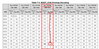

How do I set the output voltage pin-strap to be 0.99V for example?
Looks like it's in datasheets table 7-3 on page 36, but not sure or how to decode it...
Pls help.
Tim
  • Hi Tim,
    Table 7-3 is broken into columns for each value of RLB. Each column has two sub-columns for VBOOTA and RHB
    To determine the resistor values for a VBOOTA of 0.99V you should find where in the table corresponds to 0.99V then check what RLB column it is in to get the RLB value. The RHB value will be adjacent to the VBOOTA value, in the same RLB column.
    So for 0.99V, RLB = 49.9 kOhm and RHB = 124 kOhm.
    Troy
