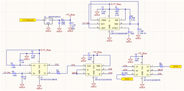

I am designing a 4-phase interleaved PFC. I have designed the 2-phase version of it. In the 2-phase version, I have used the internal Oscillator. In the 4-phase version, I have to use 180 degree phase shifted external Sync signals. I have designed a 555-timer and D Flipflop based circuit to generate the signals. Can you please review the attached circuit and see if I can use it to generate the sync signals ? Please recommend any changes if the circuit has issues.

  • Hello Zaka,
    Overall, your SYNC circuit looks pretty good.
    I recommend the following modifications:
    1. Narrow down the time that 555_Out is low to about 300ns wide.  You want the SYNC-x pulses to be as narrow as possible without being less than 200ns.
    2. Use the upper Schmitt-trigger buffer (at U3-1, 6) to generate a time-delayed signal, instead of a CLR signal.
        U4 does not need to be cleared at power up.  It does not matter which SYNC-x output gets started first... it is irrelevant to interleaving.
    Instead, feed the "CLK" into the RC at U3 pin1 input (in addition to into U4-1).  Configure R3 and C9 values for ~20ns time delay.
    Change the "CLR" output at U3-6 into "CLK_DLY" and feed CLK_DLY into U5 pins 1 and 5.
    This time delay into the NOR inputs will allow Q-FF and QB-FF to toggle states and settle before the CLK_DLY arrives so that SYNC-1 and SYNC-2 can be glitch-free.
    No race conditions with the U4 outputs.

  • Dear Ulrich,
    Thank you for a quick and detailed response.
    I have made the suggested changes in the design. Please review them and let me know if I missed anything.
    Thanks.
  • I would like to add one more question. Is it OK is the amplitude of the Sync pulses is 5V ? I think the internal oscillator generates pulses of amplitude 3V.
  • Hi Zaka,
    It is okay to run SYNCx amplitude to 5V.  The Absolute Maximum rating of the RDM input is 7V, so make sure there is no significant overshoot.
    I checked the structure of your redesign.  It looks good to me.  I did not calculate the timing; I assume you can fine tune your prototype during evaluation.
    Ulrich
