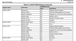

  • Hello Steve,
    5)Below are screenshots from the datasheet & the User's Guide with the settings for device:
    BUCKs 1, 2, 3, & 4 have the same setting of 5.5A & BUCK5 with 3.5A current forward setting limit.
    With a PVIN of 3V3, being sourced from VCCA, you can calculate the inductors based upon the variance from the above. Since the inductors themselves have variance you may shoot from some percentage above the worst case scenario. Hope this helps.
