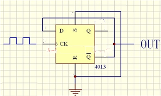

    You need to design a frequency divider circuit to help achieve this.
    For example, the below is 1/2 frequency divider, so you can use Q to sync one IC and NQ to another to provide 180-deg phase shift.
  • Thanks Hong. This didn't really answer my question. I wasn't asking how to do the phase shift. There are many possibilities for doing this. I was asking how to configure the Master UC2526A device and subsequent Slave UC2526A devices for synchonisation with the slavves phase shifted relative to the Master device.
