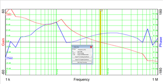

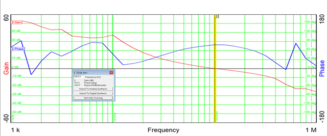

My customer is testing our TPS548B23 EVM on bode plot.
We change Lout to 0.82uH and vout setting to 3.3V, frequency change to 600kHz.
At 0% and 50% load, the bode phase margin are under 45 degree. That looks just fail at boundary, I think changing ground and measure again, might see different results. Another thing, if this doesn't work, will you suggest to change any components?
Could please help to check?
Bode test waveform as below for your reference.
Fig1. 0A, Fsw = 600kHz
Fig2. 8A, Fsw = 600kHz
