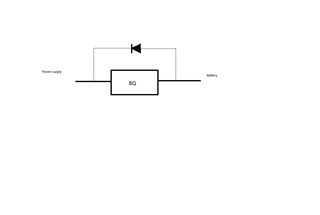

    Now we are facing a problem that is looping current. I am sharing with you a picture which is the conclusion of my overall circuit.
    When we charge battery in boost mode a looping current flows through this diode and this diode circuit is necessary to discharge battery at high rate in discharging mode, how can I prevent my circuit from this looping current (this type of 4 channels works in parallel mode).
  • Hello Engindi,
    No problem. Let me know if the BQ25820 works for your project.
    For the diode, I have a few suggestions:
    Can you disable the BQ device when the power supply's power fails?
    Can you use the BQ25820's power path or auto reverse mode instead of a diode? This should allow the input supply's current and the system load current to be separated. The BQ25820 won't oscillate in this configuration.
    Also, keep in mind that voltage from the battery can flow through the high-side FET's body diode and into the input power supply because the BQ25820 only has 2 FETs.
    Let me know if either of those solutions will work for your system.

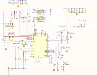

    • The updated schematic is same as per the guide of BQ25820 schematic, we put this IC in BQ25756 module which we already brought, we removed some mosfet (boost mosfet) and put the input common source mosfets, SYS mosfets, 0E along with the required short resistor same as in BQ25820 user guide.

    We have 2 board.
    1. BQ25756 module in which we have change all thing according to BQ25820 so you can understand there is nothing to change schematic. ( all components placed as per BQ25820 Module user guide )
    2. We make a PCB according to BQ25756 and now we change it according to BQ25820 ( optional components not placed in this PCB ) , I am sharing with you updated Schematic according to BQ25820
    We found same scenario in both PCB ( Module and our PCB)
    Input voltage is 29V
    Battery voltage is 26V
    Updated schematic
    It is look like BQ25820 Boost Battery voltage and flash it on Input side.
    There is nothing changed in Resistor file (software side) all value are in by default setting , only hardware thing we changed.
    I will share you register file as soon as possible.
  • Please find attached file.
    RED mark we removed.
    BLUE mark we placed.
    R9, R1005 , R1003 we placed 0E which are in bottom side.
    R32 -18K at the place of 0E.
    R12 0E and D1 15V zener in bottom side.
  • Hello engindi,
    I understand nothing was changed in the software, but the BQ25820 also has status registers that could indicate what the issue is. Please send register information.
    Christian.
