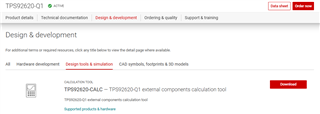

1. I would like to know if you have calculation sheet for TPS92620-Q1 device and thermal sharing resistor to see power dissipation and current graph for each input voltages.
    The external components calculator tool can be found in the TPS92620-Q1 product page under "design and development". You may refer to the page labelled "RES power distribution" in the calculator tool.
    https://www.ti.com/tool/download/TPS92620-CALC
