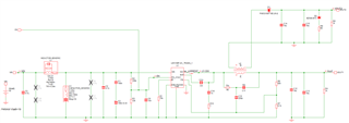

I am using this IC for my project,
Requirement is : 10V output voltage and 300 mA current.

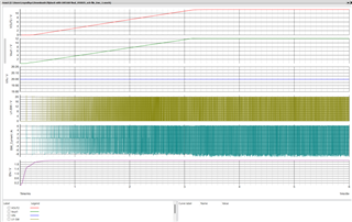

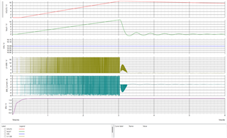

1) Input voltage range mentioned in datasheet as 6V to 115V, while in simulation I am not getting output up to 19V. Why so ?
2) What is output voltage for Bias regulator and threshold for VDD UVLO ?
