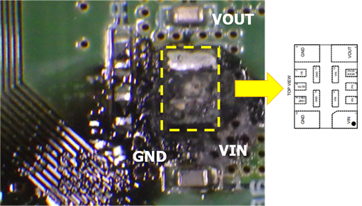

Our customer using this device and tested on the board whitch they designed.
When the test, one device was failure by burnout. From the failure occure only one case, low frequency of occurrence, we think this burnout is from damage during implementation and overvoltage mainly.

    Incidentally, below picture is the burnout device in this case.
    Could you estimate waht block in Functional Block Diagram is broken from this?
    teritama
  • Hello Teritama,
    from the picture the issue seems to be located more on the VIN side. But it is not meaningful to conclude from that, because it is a SIP (System In Package). There is an inductor on top, covering the entire device. Maybe it was no device issue at all. Maybe it was just a short below the device form soldering process. It is really hard to say.
    If it was a device damage, then over-voltage stress at VIN would be the most likely root-cause (knowing that from other older devices).
    Andreas.
