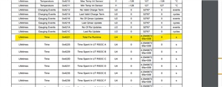

Hi Team,
Customer feedback that the recorded FW runtime in lifetime flash is only 1600hrs, but their pack has been ship out for over 2 years.
Customer want to know how FW runtime accumulated and will shutdown mode or other factor will stop FW runtime record?
