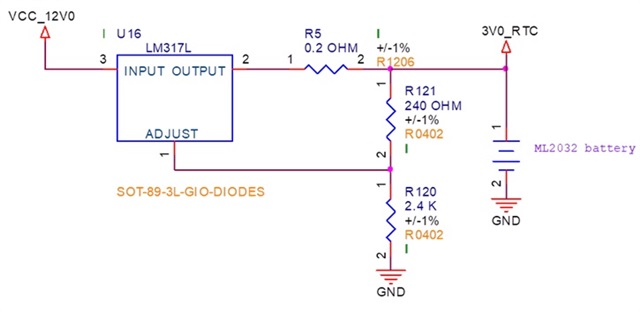

Hi Team,
any suggestion or modification for this schematic? thanks for your help and learn from you,
  • I would modify the resistor values:
    R5=0Ω,     R121=250Ω,     R120=350Ω
    As it stands, the circuit will hit max Vout trying to reach 13.7V.
    What's the purpose of R5? Is it a discrete resistor or modeling something else?
    I'm assuming you want VOUT = 3.0V

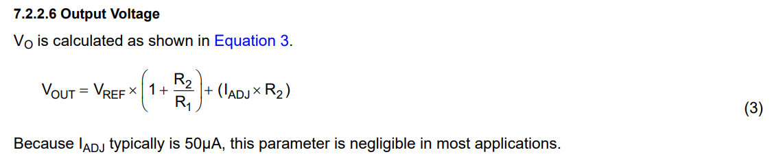

    The ratio between R121 and R120 can be calculated per the datasheet:
    And it needs to be scaled such it draws above the minimum output current:
      R121=250Ω  &  R120=350Ω   will give you give you feedback to 3.0Vout while pulling the minimum 5mA.

  • Hi Sir,
    ok~got it, but we see in the datasheet that typical value of the reference voltage is 1.25v, per the schematic and formula, so as figure below:
    R2 correspond to R120, R1 correspond to R121,  is right?
    if R5 modify 0 ohm, so R120 should be 250 ohm,  R121 should be 250 ohm,  right?
    thanks for you help and learn from you.
  • Hi Tommy,
    That is correct, R2 maps to R120 and R1 maps to R121. Making both 250Ω would give you an output voltage of 2.5V, which would work if that is desired. I had assumed you wanted 3.0V volts so I sized them as R121=250Ω & R120=350Ω.

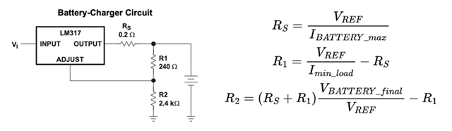

    Just to clarify: R5 would be nonzero if you want to limit current to below a specific value. Some applications require this, but a value of R5=0.2Ω is somewhat useless on the LM317L because it would hit the LM317L's own internal current limit before any additional protection. Here are the formulas for that if you are looking for a specific current limit:
