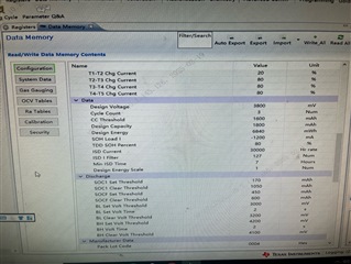

Customer feedback battery pack will randomly trigger ISD fault after completing charge. We record log for your reference. And my question is that is selfdischargecurrent accurate? how often selfdischargecurrent will refresh?  How to set ISD threshold is correct?
Below is battery configuration and log data which ISD is triggered.

    Customer configured that Design capacity is 1800mAh, ISD current is 3000Hr rate, So ISD threshold is configured as -1800/3000=-0.6mA. Is this wrong?

         The accuracies of the gauge is more precise than 1mA and is more than enough for the application however we noticed that based on the current picture above of the data memory you have the ISD threshold set at 30,000Hr rate which means you ISD threshold is -1,800/30,000=-0.06mA which is extremely low and would definitely explain all the false positives.
         Most clients leave the ISD threshold at the default(10Hr rate) but if you would like to set it to conservative rate for it to only work on new and quality cells that try to set your SelfDischargeCurrent() to trip at 1mA or -1800/X=1mA -> X=180Hr rate

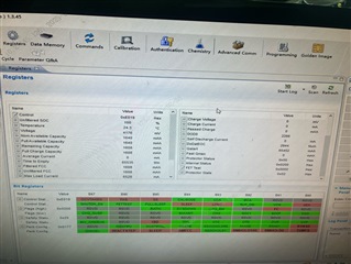

     May I know how to calculate OCV from selfdischargecurrent? As the log data showed, selfdischargecurrent of battery 1 is -7. How to know the OCV points where -7 comes from? Thanks!

    There might be some confusion since the selfdischargecurrent is measured in mA meaning that your system is discharging at 7mA. OCV is measured from the BAT and VSS pin during periods of no load on the cell. OCV and selfdischargecurrent don't necessarily effect each other directly since OCV measurements wouldn't be taken during discharge periods.

    The reason why asked this question is that if you checked the log data, the voltage of battery didn't changed a lot. But the selfdischargecurrent indicates battery voltage changed a lot. And for a normal battery, the selfdischarge current should be in uA level. So 7mA is too large to believe. Customer doubt if the selfdischargecurrent is correct.

    I misspoke on SelfDischargeCurrent(), but in terms of the way it is calculated you can find it in section 2.2.1.5 of the technical reference manual. However to properly answer the question from yesterday, you would know the OCV points are coming from an 1 hour interval and the charge elapsed would compute the selfDischargeCurrent(). If the customer does see a 7mA than there is some kind of load within there system and also I agree that this is unusual but I also believe that it wouldn't be coming from the battery gauge end due to the lower power use used on the IC.
