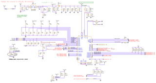

We have many platforms using the UCD90124A.
Currently, one platform encounters an issue where the UCD does not respond during an x86 online update. After this, our online update process powers off and restarts. At this point, the UCD is in an erased state and empty. Since two PSU_PWR_OK signals are also connected to the UCD, it gets pulled low by the UCD.
As a result, our system cannot power up again.
Could you please help identify the cause of the UCD not responding halfway through the update? And is there any solution to this problem?
We have tried resetting the UCD and attempting the update again when it doesn't respond, but the issue still occurs intermittently. This causes the online equipment to potentially fail to power up again.

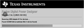

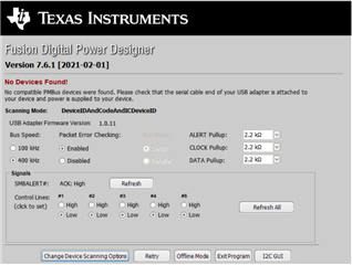

  • Hi Yihe :
    Please see the pic below to check using TI USB dongle failure
    We have made sure that the burner is indeed connected to the device.
    Please give some advices, we have also use the i2c logic analyzer to inspect the UCD90124A  behavior. It was observed that when writing an i2c command to UCD90124A at a certain times, the command was sent but the device did not receive it,. If you need the i2c analyzer log, I can share to you.

    Did you try to upgrade TI's own firmware? That's something you shall avoid.
    Customer shall only touch data flash section instead of program flash.
    Program flash contains TI pre-loaded firmware and if firmware is broken, fusion can not detect the device anymore.
    Please follow this doc
    8228.recover UCD90124A from ROM mode.pdf
    Yihe

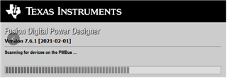

  • Hi Yihe :
    Please refer the results below for the success log and failed log
    Success log :
    Failed log :
    The success log and failed log are using different platform but the UCD device is same which is UCD90124A.
    Our TI fusion GUI please refer below :

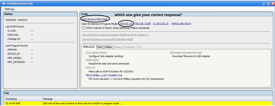

  • Hi Yihe:
    How do we run the ROM recovery checking test through our TI fusion GUI? Do you have the SOP or others doc that can share to us? Our TI fusion GUI will scan the device first, if the device is not found, the ROM recovery checking test can not be continued.

  • Hi Yihe
    As I mentioned before, the doc that you offered to us can not be continued through our TI fusion GUI. The first step will failed due to the device is not found.
  • Hi Yihe
    • As I mentioned before, the instruction that you provided to us previously can not be continued through our TI fusion GUI due to the device is not found. The first step is failed, so the others step can not be continued.
  • Hi
    Which button gave your correct response? Please provide the snapshot
