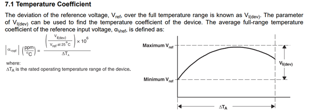

    For the TL431AQ please also see below for the tempco calculation using Section 7.1 of the datasheet:
    temp min: -40C
    temp max: +125C
    Tempco: 82.6ppm/C
    I hope this helps!
