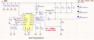

Dear TI-,
I 'm writing to request a review of my design. The project specifications are as follows:
  • The LED driver will be driving 3 LED @0.7A, connected in series (with 3*Vf = 3*12V).
  • Vcc = 48V
  • Switching frequency = 100KHz
EN will be connected to a PWM signal and ADIM/HD is pulled up with 10Kohm. FAULT is left floating.
PGND and GND are connected with 0ohm resistor.

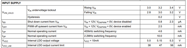

Questions:
  • Does the UVP circuit need any tweaking?
  • What happens to the internal LDO during a Fault condition?
