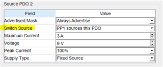

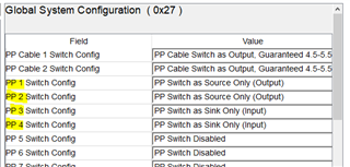

    1st you need to configure the powerpaths to support the desire power role in Global System Config(0x27). PP1 and 2 are the internal power paths on TPS65988, PP3 and 4 and are the external power paths.
    Then, you need to configure the desired PDO in Transmit Source PDO(0x32) to have the desired Switch Source. Each Source PDO needs to be configured.

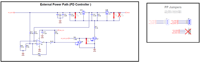

    HW:
    You primarily need the external power path. See the datasheet and attached app note for supported protection. Any other protection, (things like RCP and OCP) need to be provided by you external circuit design.
    The 988EVM provides and example of the external Sink power path. We do not have a 988EVM that uses the external path for sourcing.

  • Hi AE,

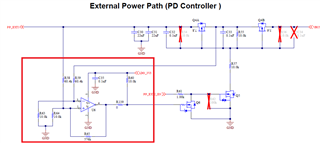

           Thanks for your answer! I have some questions I'd like to ask.
           1. What is the function of the red box? Is it necessary to add it?
    If that is from the TPS65988EVM, it is a discrete RCP circuit for a dedicated external sinking path. If you look closely, if the PPEXT1 node has a greater voltage than the node between the FETS, it will drive the output high and enalbe Q6. This will disable the output of the FETS and disable the power path.

    3.  Besides these settings, is there anything FW setting else that needs to be noted?
    Make sure you configure global system configuration correctly, specifically the power path roles. Also, make sure you set the Power paths in Transmit Source Capabilities to the desired power path for each PDO.
