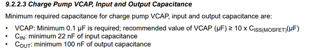

I want to use this FET with large requires high capacitance attributes.
https://www.digikey.be/en/products/detail/analog-power-inc/AM90N08-04B/23019514
Total Gate Charge = 167 nC
Reverse Transfer Capacitance Crss = 970 pF
I can't find anything in the datasheet comments on selection criteria based on capacitance attributes.
Are there any implicit timers/mechanisms expect FETs of a certain size, which would therefore have problems with 'larger' FETs.
