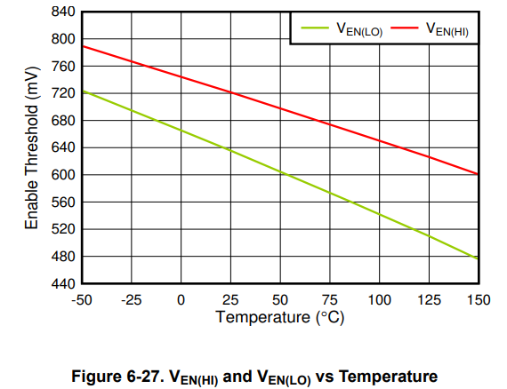

TPS745-Q1: VEN(HI): EN VIH max
Part Number: TPS745-Q1
Hi team,
Considering the following thread and the EN threshold vs. temp curve. I think the max value of VEN(HI) should be 1.0V not the min value is, right?
Similarly, the min value of VEN(LO) should be 0.3V not the max value is, right?
https://e2e.ti.com/support/power-management-group/power-management---internal/f/power-management---internal-forum/1205933/tps745-q1-the-value-of-the-ven-hi/4548345?tisearch=e2e-sitesearch&keymatch=tps745%2520enable#4548345
BR
Haury
