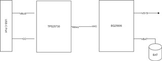

Dear TI,
I would like to use the BQ25606 for its standalone feature, but I would need a guaranteed 2A minimum input current (no SDP, no divider 3) and I don't think there is a way to configure the BQ25606 this way.
Would you recommend adding a USB PD controller like the TPS25730 in front of it? So that I have a guaranteed input power (5V, 3A) from the input charger?
Or there is another simpler way to implement a standalone USB power + charging with at least 2A input capabilities (1A charging + 1A system)?
Thank you
