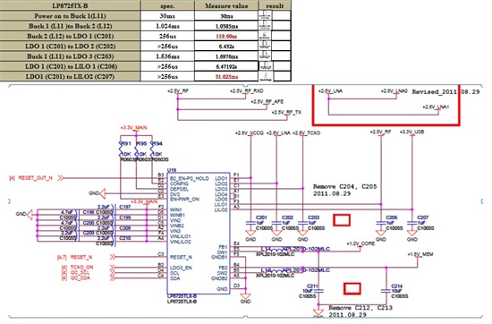

1) Buck 2 to LDO 1 about 119.60us is smaller than SPEC.
2) LDO1 to LILO2 is no in SPEC, LILO2 is earily LDO1 31.025ms
Measure value
Measure value
