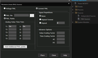

2. I tried using the Modeling Application > PWL Sources, but it is locked.

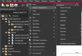

  • Hi Charlie,
    I am using the same version of PSPICE for TI as you but I do not see Modelling Applications as blocked:
    Maybe you can try reinstalling PSPICE and check?

  • Hi Taru,
    Thanks for your reply.
    In the image below, the modeling application appears in gray text and cannot be selected.
    Regarding question 3, as shown in the image below, an error message appears: "The unit for the parameter value of DC is not in the database."

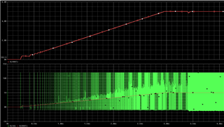

  • Hi Charlie,
    You can use a simple voltage controlled switch:
    This is how I implemented.
    Results:
