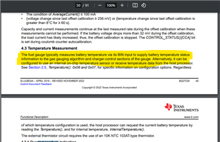

1. May I ask if bq27220 uses an external temperature sensor or an internal temperature sensor for the temperature data in the data logs when obtaining the CEDV profile?
2. Does the NTC model have to be 103AT when selecting a lithium battery with NTC? Can I use NTC model 175?
