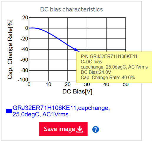

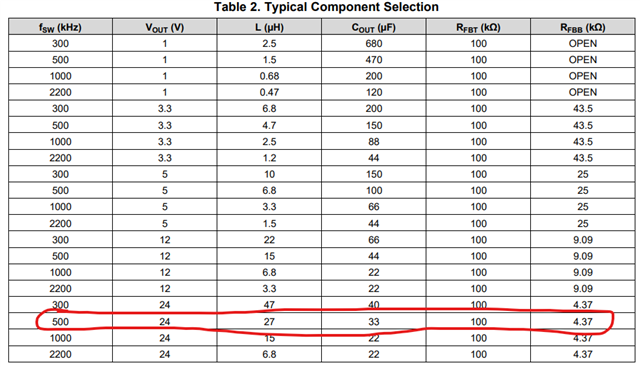

    Looking at the above table, you inductor looks correct, the feedback resistors are correct, but the amount of output capacitance is lacking. I suggest adding more output capacitors. Remember, the capacitance of a ceramic capacitor has capacitance derating when a voltage is applied to it. For example, a 10uF/50V/X7R/1210 capacitor from Murata has a capacitance value of 59.4% of its rated capacitance. See below:
    This means at 12V output, the capacitor has a net capacitance of around ~6uF. Therefore to have 33uF of capacitance shown in the table, you will need 6 X 10uF capacitors for your design.

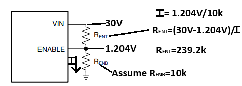

    • As you mentioned about the mapping of the EN pin and 24V_SHUTDOWN signal. I will connect the 24V_SHUTDOWN signal to the enable pin, but will the enable pin be connected to Pvin (Vinput)? Or it will only connect to the 24V shutdown signal.
    • There is one more option given for enabling the pin: Precision enable. I went to the datasheet and tried to understand this. It seems that we need to select the voltage divider and the enable voltage value. But in that case, how can I select the resistor values and voltage on the enable pin? And how can I map this 24V shutdown signal?
    • How will this enable pin be used for UVLO feature, resistor selection, and 24V_shutdown signal mapping?
    Can you clarify the above queries and explain the things with one example

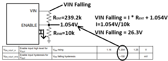

    Above is an example of how to calculate the values of the EN resistors. In this example, I assume a VIN of 30V that will enable the LM76002 device. When VIN is rising, the LM76002 will turn on at VIN=30V.
    The picture below shows when VIN is falling, the LM76002 will turn off at 26.3V. Therefore, the EN circuit provides a VIN_UVLO to turn on and off the LM76002 device.

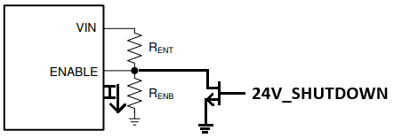

     To use the 24V_SHUTDOWN signal, see below. Depending on the logic of the 24V_SHUTDOWN, you may need to invert the signal.

    But as you mentioned about the output capacitor calculation, which is 33uF (equivalent value at output voltage) This value will be for full load condition. I have done the simulation for 24V @2A requirement.
    Vin Range: 44V to 50V
    Vout: 24V @ 2A
    So, the O/P cap calculation comes around 10 uF with ECR value 857.38 nOhm for 22.056 mV Peak-to-peak output ripple voltage. But I am good for higher value of ripple requirement. I need to meet above calculated value.
