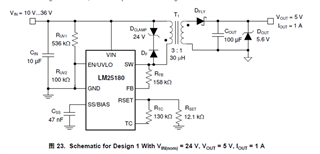

LM25180-Q1: Why LM25180 need zener diode at output?
Part Number: LM25180-Q1
Other Parts Discussed in Thread: LM25180,
Hi expert,
My customer has a question about Dout in below reference design.
I don't see other flyback reference design that need zener diode at output, why LM25180 need this? Is this for some special purpose?
