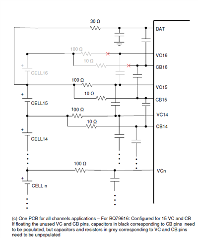

Hi, Experts,
In datasheet of BQ79616, unused VC and CB channels, it said the differential capacitors between CBn and CBn-1 need to be populated.
but if all CB are not required at all, shall we just keep all CBs floating which is good enough? no impact on VC measure accuracy?
thank you very much.
