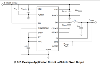

LM61495: 5V fixed, but output is 1V
Part Number: LM61495
Hello engineer:
    We follow the datasheet, used the " 9-2. Example Application Circuit - 400-kHz Fixed Output", 5 Fixed Min Bom; but the output is 1V.
    The Example:

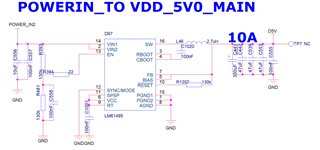

    Our sch:
Powerin is 24V, is there any problem with the schematic diagram?
