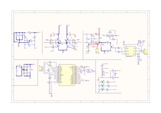

    Thanks for your advice!Our circuit diagram is shown in the attached image, the input label in the diagram represents the input DC voltage, and in the upper right corner of the diagram we have additionally added a MOSFET discharge circuit containing the driver chip.
    In the current test we set the resistor R33 on the TS side to 1 ohm and input 3V to the TS pin, the SCL, SDA and INT pins are still left floating, but the chip is still not working properly, there is no power supply to the REGN and buck-boost circuit pins of the chip. We have input 15V to the input label, the battery is replaced by a 10V constant voltage load, which should be within the operating range of the chip according to the size of our resistor programming. But now we can only observe the light emitting diodes blinking at the PG,STAT1,STAT2 pins, and we think that the voltage at REGN here is generated by the 3V we gave to TS. We have checked the chip soldering again and it should be fine, where do you think we should modify it?

    Thanks for sending the schematic. I have a few questions/suggestions for the schematic:
    • Can you send me the data sheets for the FETs, inductors, and BTST diodes?
    • Make sure the BTST diodes are schottky diodes
    •  Can you short R30?
    Besides that, you mentioned that we should set EN_PRECHG=0 if we use resistive load instead of battery, do we still need to set it if we use constant voltage load?
    No, you don't need to set EN_PRECHG=0 if you use a constant voltage load.
    I would make sure the that the BTST diodes are schottky diodes and make sure that the VGS(th) of the FETs is around or below 2V. |
    Can you also measure the output of VBAT, SW1, SW2 and REGN with an oscilloscope.
    If possible, I would also recommend reading the I2C status and flag register to see what the IC's status is.

    Thanks for the new information.
    I'm looking at the FET datasheet and I see that the typical VGS(th) is 2.8V with a maximum of 3.5V. Can you increase the voltage supply on DRV_SUP to see if the charger works then? Make sure to disconnect DRV_SUP from REGN when you do this. You can also try to use FETs with a lower VGS(th).
    Can you also use an oscilloscope to measure the input voltage and make sure the input voltage is good?

    Resistor programming:
    1. Yes, you can do this. Just make sure to use a 3V DC source or 3V from a resistor voltage divider.
    2. Do you have a battery connected in this configuration? I can think of a few scenarios that might cause this:
    • Scenario 1 - No battery or no load: The BQ25756E is charging the output capacitors and then reaching the termination current. When the VBAT capacitor voltage falls, the BQ25756E goes into recharge mode and starts the process again.
    • Scenario 2 - With a battery or load: The BQ25756E is pulling too much current from the input supply causing the power to brown out. The input supply then comes back up and the BQ25756E starts trying to charge again. You've already measured the input voltage with an oscilloscope so I think this is unlikely.

    Thanks for your advice,recently we have made some progress,now I would like to ask if both VAC pins(33 and 32) of the BQ25756 chip need to be connected together if  the chip is only used for positively charging for only resistor programming?
    Thanks in advance!
    Yes, both VAC pins will need to be connected together.
