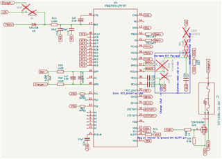

    Are you using the BQ76942 EVM per chance or is this a custom board? If it is a custom board, can you share your schematic?
    Alexis
  • I still can not turn on the Fets, I removed BJT at CD, I do not know its effect to mechanism of Fets?
  • Hello Hai,
    Are you using the EVM or a custom board? If it is a custom one, do you mind sharing a pdf of your schematic so that I can see what you are referring too?
    As for the BJT at CD, are you potentially referring to the one that connects to the BREG pin?
    Alexis
  • Hello Alexis_H,
    Yes, of course
    I means BJT in BREG, I removed it and any thing work well without controlling FETs. I have more questions, whether if I removed Themal resistor in TS1, TS2, TS3, It will be in conditions that can not balance cells. I have read in *Cell Balancing With BQ769x2 Battery Monitors (Rev. A), if violating thermal conditions, cell balancing can not be activate. So, if I removed all these resistor means that I can not balance cells?
    Hai Phan
  • Hello Hai,
    Thank you for sharing the image of the BREG. This previous post,BQ76942 REGIN and BREG transistor, helps explain the use of the BREG and REGIN pin more. If you do not plan on using the LDOs REG1 or REG2, then I would disable it. Even if BREG and REGIN are not being used, BREG under short-circuit conditions can draw up to 3.33mA as shown in Section 7.11 REG0 Pre-regulator of the datasheet. If you want to disable the pre-regulator, you will need to do so in the settings. Further details can be found in Section 6.3.1 Preregulator Control in the TRM.
    The device includes an internal die temperature check that can disable balancing if the die temperature exceeds a programmable threshold. Removing the resistors of the external thermistors should not affect the internal die temperature check, however, it could ruin your thermistor measurements if they do not have a pull-up resistor, and you are not using the devices’ internal pull-up resistor.
    Also, I see you mentioned using TS2 as a thermistor. This means the device will not ever be able to completely enter SHUTDOWN mode and enter a ‘soft shutdown’ mode instead if the shutdown sequence is initiated.

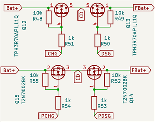

  • Hello Hai,
    Could you share how your DSG, CHG, PCHG, and PDSG are connected as well? Are you using DDSG and DCHG as DDSG/DCHG functionality?
    If my charger's voltage exceeds my charger's voltage,
    Could you clarify what you mean by this?
    Do you have a configuration file or .gg file (from bqStudio) you can share of all the configuration changes you made?
    Alexis
  • Hello Alexis_H,
    Here is my schematic related to CHG, DSG and PCHG, PDSG
